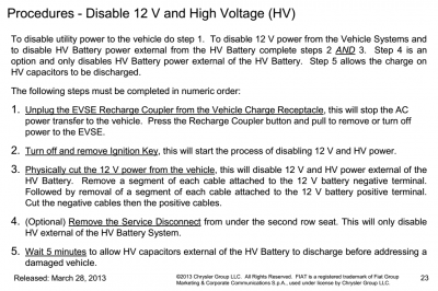

Вот здесь документ "Fiat 500e First Responders Guide" : https://www.nfpa.org/-/media/Files/Training/AFV/Emergency-Response-Guides/Fiat/FIAT-500e-EV-2013-2018-ERG.ashx?la=en
Procedures - Disable 12 V and High Voltage (HV)
To disable utility power to the vehicle do step 1. To disable 12 V power from the Vehicle Systems and to disable HV Battery power external from the HV Battery complete steps 2 AND 3. Step 4 is an option and only disables HV Battery power external of the HV Battery. Step 5 allows the charge on HV capacitors to be discharged.
The following steps must be completed in numeric order:
1. Unplug the EVSE Recharge Coupler from the Vehicle Charge Receptacle, this will stop the AC power transfer to the vehicle. Press the Recharge Coupler button and pull to remove or turn off power to the EVSE.
2. Turn off and remove Ignition Key, this will start the process of disabling 12 V and HV power.
3. Physically cut the 12 V power from the vehicle, this will disable 12 V and HV power external of the HV Battery. Remove a segment of each cable attached to the 12 V battery negative terminal. Followed by removal of a segment of each cable attached to the 12 V battery positive terminal.
Cut the negative cables then the positive cables.
4. (Optional) Remove the Service Disconnect from under the second row seat. This will only disable HV external of the HV Battery System.
5. Wait 5 minutes to allow HV capacitors external of the HV Battery to discharge before addressing a damaged vehicle.
Порядок отключения батарей
